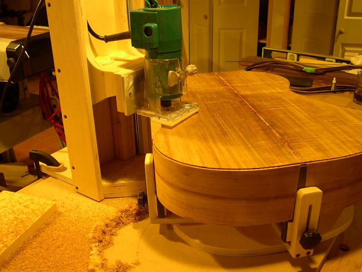

PostPosted: Thu Jun 21, 2007 7:16 pm
[QUOTE=Ricardo] But do you want to keep it 90 degrees to the side.  How does it handle a sloping side?
Rich,
To keep the cut depth where you set it you need to keep the plane of the router bit and laminate trimmer guide bearing at 90 degrees to the tangent of the side as the router bit is not in the centre of the guide bearing as with an integral router/bearing bit.
The small donut deals with the slope/curvature of the top and back where it meets the sides. To follow the longitudinal curvature both the Williams-Fleischman jig and my modification needs the top/back surface set at 90 degrees to the line down through the router bit and you do this by adjusting the support frame appropriately for each part of the cut.
